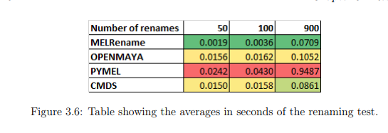

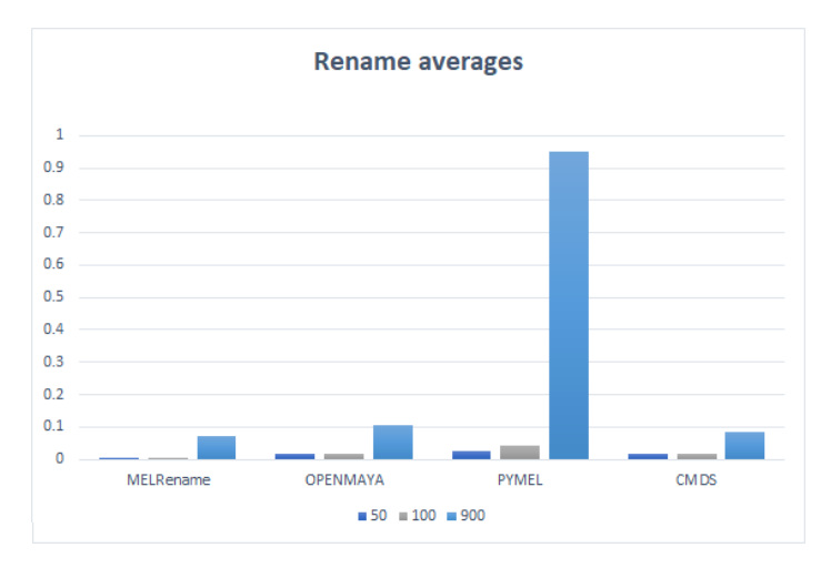

Speaking of mel renames, suprised to see how fast mel can be (oh so rarely):
Although at 900 cmds catches up. I guess that makes sense python does have a virtual machine.
Page 26
https://www.diva-portal.org/smash/get/diva2:1334763/FULLTEXT02

Just an fyi @dive, python isn’t actually the cause of slowdown here. The column labeled “CMDS” is actually referring to “maya.cmds”, running in python. “OPENMAYA” is actually running “maya.OpenMaya” in python as well. The pymel package is the culprit, not the python language, which for many things can be faster than mel. Pymel just instantiates a lot of objects when it returns data and uses more memory, and as a result is slower.

But look at the first column “MELRename” [Thats regular old MEL not PyMel right?]
Not that it matters, rename isn’t performance critical, but could you explain that?
For objects between 0-100 MEL is faster than OpenMaya, Pymel, and Cmds. (?) More than twice as fast. (No I am in no way advocating MEL trust me haha)
My guess is that before 900 objects, Python[cmds] is paying a startup cost, but at 900 you can see MEL’s lead diminish significantly. (Ignoring PYMEL, we all know thats super slow haha)
I haven’t tried it out myself, but this makes no sense to me. Curious what you think?
I find it slightly annoying MEL is faster :laughing:
If you are doing this from the listener there’s probably a compilation cost. Careful management of the Python should also shave off some time too , but honestly it’s not worth getting bent out of shape over human users are unlikely to care :slight_smile:
I’d expect that importing the same function from a module (rather than running it from the listener where the def gets redefined) will cut some of the startup cost …
What you’re seeing here sounds correct to me. Plain old mel is technically faster to execute than maya python scripts, but it doesn’t handle things like code libraries near as well, and importing files takes a lot longer than in python if you have a lot of them, from my experience at least.
My main point is that the loss in speed isn’t necessarily the fault of the python language, but rather the way the cmds, OpenMaya, and pymel libraries are implemented.
But, as @Theodox said, it doesn’t actually matter at those speeds, with the exception of the PyMel 900 case. You have to have a delay of at least 15ms before you start to notice it for things like audio and realtime applications, but for user facing tools like a renaming utility the user isn’t going to notice any slowdown until you start running into delays of 1/8th a second or greater. And even 1/8th a second to rename 900 objects for example may still seem small enough to the end user to be acceptable. Most commercial touchscreen devices have a latency of between 50 and 200ms, just to put that into perspective.
