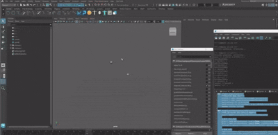

I’ve actually implemented this approach as a custom constraint in Maya before. However, relying purely on constraints definitely introduces issues, particularly when it comes to animation baking.
In order to evaluate a bi-directional constraint within the Maya DG, the consumer and producer nodes must swap roles. This topological switch needs to be recorded at mouse click event.
KakaoTalk_20260714_082406694
I ended up solving this by making custom manipulator.
Feel free to reach out if you’d like more details.

This is a plugin. True to what was said above, you don’t necessarily have to fight with the DAG, but I took this on as a personal challenge. I’d be happy to show more demo videos if anyone is interested.
