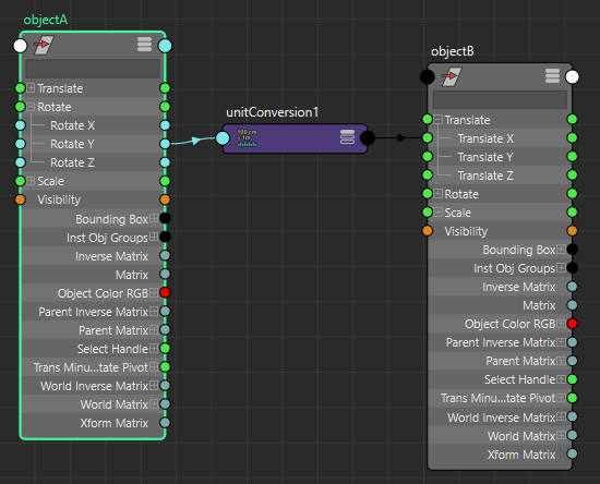

I think Max param wiring is more akin to connecting attributes via Maya’s Node Editor. It’s much easier to use than Max’s clunky param wiring interface. Great for simple stuff like connection the rotate Y of object A to the translate X object B. You just click on one attribute output and drag to another attribute’s input.
Because it’s Rotation to Translation, Maya auto inserts unit conversion node.
There are various utility nodes you can insert where you would add an expression in Max. (UnitConversion and Reverse nodes get a lot of mileage.) Super easy for one off rigging needs
for common tasks of course you want to go with scripting those connections.
