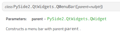

You probably want to specify a parent for your menuBar, self.menuBar = QMenuBar(self).
Probably also true for the rest of the sub objects. They are possibly getting garbage collected as nothing is being told to keep them alive.
Thanks for pointing me in the proper direction, Katz and R.White. I think I finally got something that works. R.White–you’re completely right. Much better now.
I appreciate all the help. Let me know if there is anything else that stands out.
