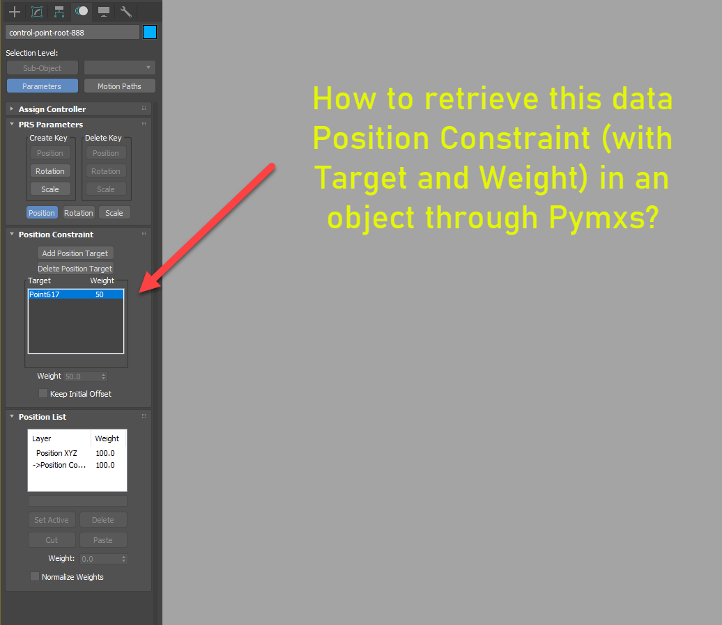

I’m trying to retrieve an object’s position constraint’s target and weight. See below for illustration.
How is this possible in pymxs? I tried using the “help” function but it returns an error

I tried using
obj.position.controller but it returns None even though there is a constraint attached.

My bottleneck is retrieving the name/target of the weight (i.e. the object it was weighted)
I tried using
posCtrl[1].controller.name[0] or
posCtrl[1].controller.target[0]
but it doesn’t work

getNumTargets()
getNode <index>
getWeight <index>
are what you want

Thanks for the response.
the getNode(), getWeight() and `getNumTargets)
works as expected!
Thanks for linking the doc. I searched it earler but I just couldn’t find where it belong.
