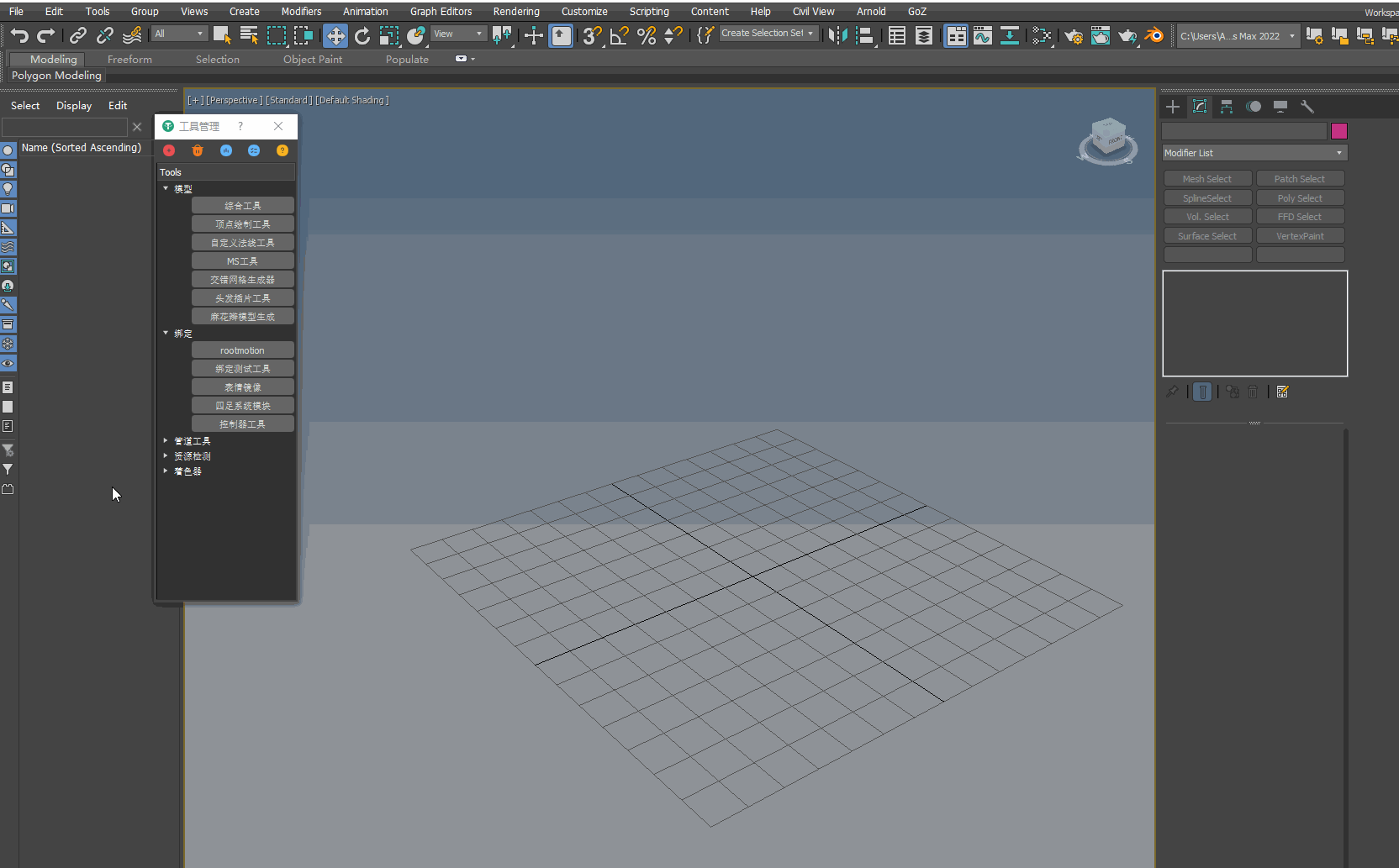

When I import objects, the position of the window will be forced to the center
mycode

do you have a callback that is regenerating the ui on import?
I change parent class, “QtWidgets.QMainWindow”, It seems that “QtWidgets.QDialog” cannot be used
