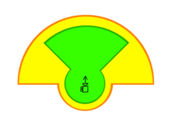

I made my scheme for level streaming:
Yellow - StreamLevelIn, loading into memory, no rendering
Orange - StreamLevelOut, loading into memory, no rendering
Green - show level
Dark Green - hide level
This currently saves 20-50% of memory.

i understand from you that you can stream levels that are in yellow area . and that look impressive and good for optimization . but the question is how can you do that in unreal engine .
when u say StreamLevelIn , you mean by level meshes and objects or sublevels or what
