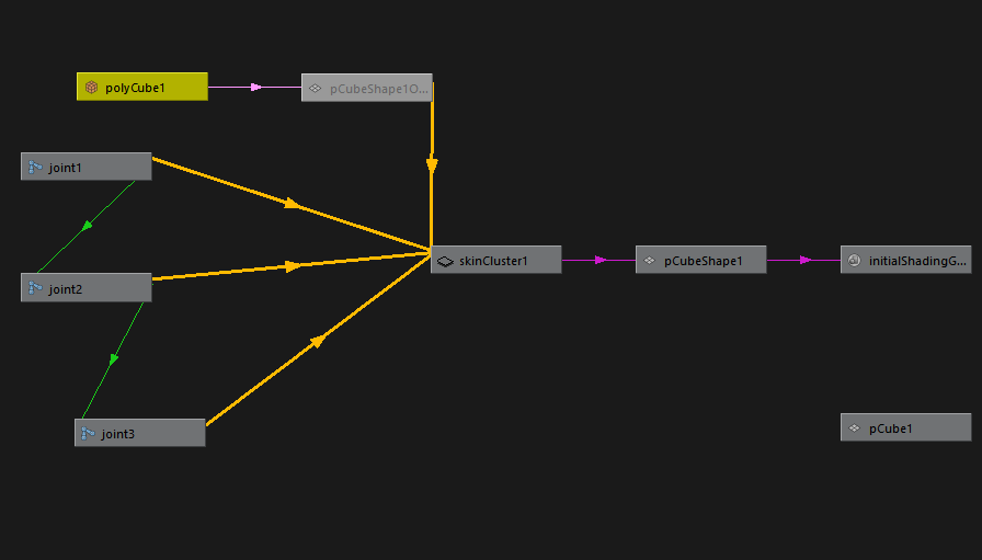

The graph we’re checking:
When performing traversal upstream, i get this:
So i t seems i get two kMeshes (296). Maybe this is the expected output of a skincluster? Another thing - why six joints in the output, when there are three?
Generally there seems to be twice the node count, when compared to the graph.
EDIT2:
Ok, so I did your reverse mapping for debug and everything seems (almost) right:
Seems like my docs ctrl+F lookup method isnt the most efficient one :laughing:
(still not sure about two meshes and six joints though)
EDIT3:
Okay, because there is a traversal path between the joints themselves as well (scale to inverse scale connection - I assume it’s the segmentScaleCompensate attribute).
Now everything’s clear. Thank you one more time, I really learned a lot today :wink:
