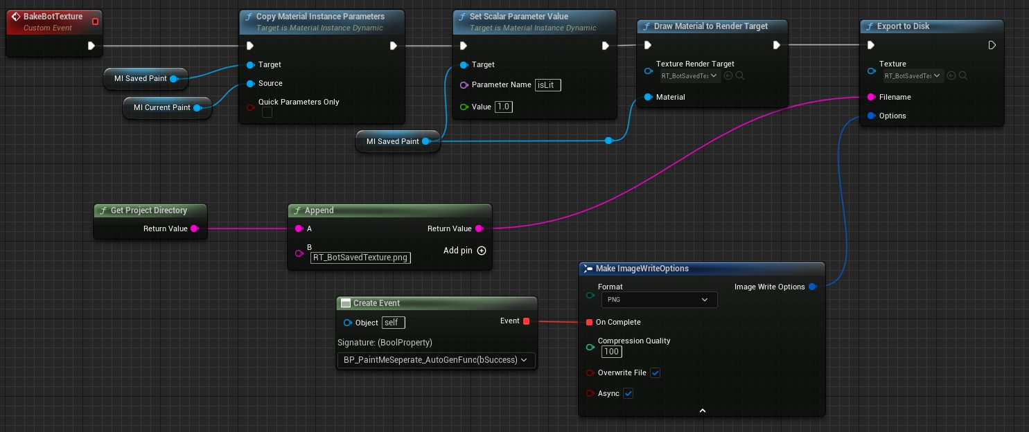

Here is a glance at my code. I double checked the tutorial and am currently getting blank Texture files exported. I can see that my Rendertarget is saving the painted on texture, but it’s not exporting.

I am no longer receiving errors, but am not seeing any color textures (Just exporting a blank empty texture that is named correctly).
— Added note, the “draw Render Target to Material” does work, I can see the texture appear after using it in editor. Not sure if this works during runtime.

We have determined that we cannot access the data of Render Target texture. Even if we save a material to the RT texture, see the RT texture exists with the painted on details in the content editor. And then export the texture FROM the content editor, the file that we export is a totally blank image.
When we used a texture file (Android icon) and hooked it up to the export and it worked perfectly. So it’s just the Rendertarget texture itself, or it’s just the Dynamic painted on material. No matter what I do I can’t seem to access the data of my ‘being painted on’ material as a file. :thinking:

Our programmer who does C++ put the linked functions into a UE5 node for me, we got it running on the project and now I can call “ExportRenderTarget2DAsPNG”. The function works with my variable RenderTargets that are edited and made in my Blueprint. So we can now export these as textures, and use those textures in other parts of the game. Which is fantastic!
FImageUtils | Unreal Engine Documentation
Pay attention to the settings of the “type” of PNG you’re working with. Otherwise you can get weird coloring and effects to your PNGs. I am going with “RTF RGBA8”.
