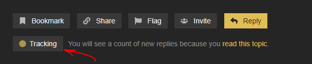

How can I close this thread?
There really isn’t an option to “close” a thread. Instead they tend to peter out organically.
You can select a certain response as a solution to a thread, which gives an indication to future readers as to how it was solved. (Though usually its best if there is an actual solution posted, that others can act on)
If you just want to stop getting notifications, you can turn them off at the bottom. Otherwise, this is an online discussion that others might refer to for years.
