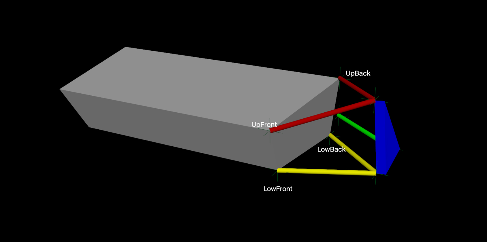

I will try to illustrate a bit better what i have in mind, but overall, i feel stuck on some “concepts” that i can’t seem to grasp. Here is a picture that i hope will illustrate well enough what i’m trying to achieve :
The grey mesh represent the car’s frame on wich are attached the wishbones. In red is the upper wishbone, and yellow is the lower wishbone. Each wishbone is supposed to be totally rigid within itself (a piece of steel).
In blue is the knuckle, wich is attached to the upper and lower wishbones by ball joints.
So, each wishbone is supposed to rotate from the axis defined by the two attach points on the chassis. For example, for the upper wishbone, the rotation axis is supposed to be a line between “UpFront” & “UpBack”. Same thing for the lower wishbone (yellow). Up to there, it would have been kind of easy to just have one bone per wishbone and aligning the rotation axis to the desired axis. But the problem is that each tip of the wishbones is supposed to be attached to the knuckle (blue). So, when i rotate one wishbone, the other would need to be driven by the first. The problem is that using an ik seems to screw the rotation axis of the first wishbone, and since the pole vector would need to be dynamic an move relative to it’s own bones rotation, it gets so complicated that i don’t even know what i’m doing anymore.
In the end, this seems like a very specific issue, but i’d like to create this rig quite flexible, to be able to move each attach points (locators in the picture) to be able to analyse the effects of moving them on the overall geometry.
