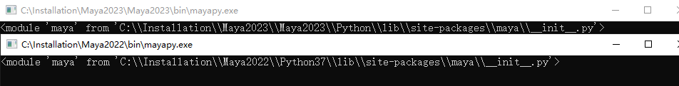

import maya
print(maya)
This will show you where maya is being imported from which could be a clue as to the problem
I put “import maya print(maya)” into the script, and then run it with Maya2023 and Maya2022 respectively., I got the following picture,They are similar.I have no clue about this.
