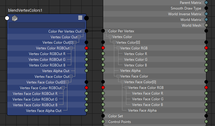

For example, do I need to match all the sub-attributes of the “colorPerVertex” compound attr exactly for the attribute to “take” (as in adding all those faceVertex attrs, even if I don’t intend to use them).
I’d love to know if I’m going in the complete wrong direction too! Maybe there’s an easier way to do all this.
Thanks!
Recreated the compound node construction and now the attribute connects! Hoping this is the start of a great plugin.
