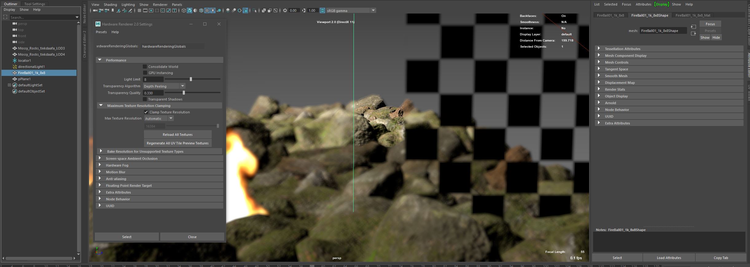

I was wondering if there was a way to access / modify the Viewport 2.0 Depth of Field effect. There is very little documentation about it. My first goal would be to make it more physically correct. ( Adjust blur amount to match an off-lline renderer ) Second make it work with transparent objects like in the attached image.

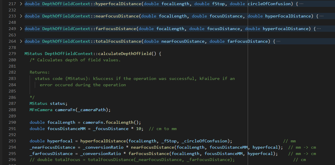

I`m recalculating the fStop value based on the simplified dof formula and coc setting.
You can find the math online. Also very important you need to work in cm so an average person will have around 185 maya units.
Then the math is a bit tricky since the dof equation has mm and cm you need to convert the distance to mm and afterwards back to cm when you want to set the values on the camera.
Then its just calculate the closes distance with MFnMesh.closestIntersection - check Chad’s APi videos for that (MPxContext).
Lastly I`m setting the MFnCamera setNearFocus and farFocusDistance which will change the camera fStop values to something like 0.238 which is below the GUI’s allowed values.
This was the easiest and most secure solution for my v.1.0.0 becasue I`m not messing with any internal settings - if you delete the keyframes on the camera everything will go back to stock settings.
Now from what I have researched maya viewport 2.0 is a straight - foward renderer so we will never have access to all the fancy stuff like render buffers so we have to stick to something like this:
This is what is happening and what I believe why the devs limitted the dof effect to what we have.
If you would like to get per pixel dof with alpha textures you would have to write your own shader for that i guess.
https://help.autodesk.com/view/MAYAUL/2016/ENU/?guid=__cpp_ref_struct_m_h_w_render_1_1_m_frame_context_1_1_d_o_f_params_html
This is how they calculate it.

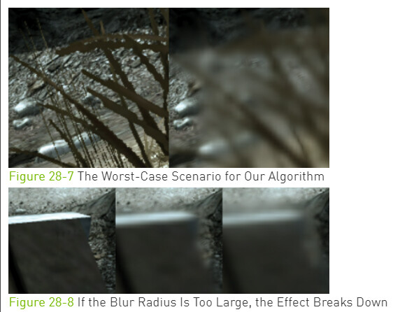

Yeah, that is really helpful, thanks. We’re really looking for a solution whereby the viewport DOF is reasonably representative of the final render DOF to allow previs/layout to set up cameras with some confidence. The limit on the DOF effect that you mention is, I think, what really gets in our way. We’re probably going to have to dig into Viewport 2 shader overrides. The “limitations” from the NVidia article aren’t really problems for use. We accept that the viewport doesn’t handle transparency well when it comes to DOF, also that extreme settings might cause the whole thing to fall apart.
