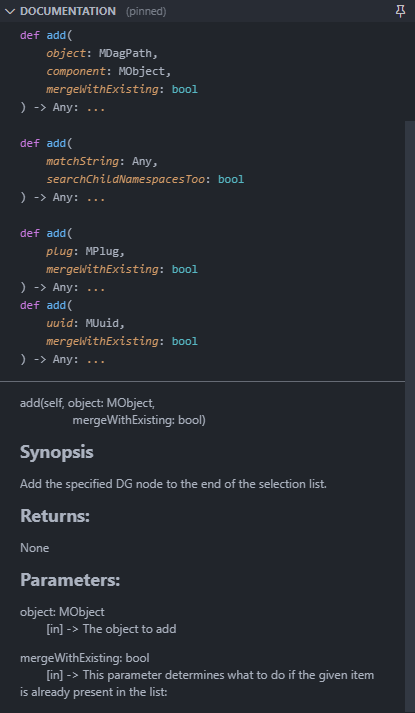

Take, for example, OpenMaya.MSelectionList()
MSelectionList add()
add() is overloaded.
The stub files I put together resulted in only one definition for add(). So I modified the generator to output all the variations. But Pycharm would only recognize one of them. Python does not support function overloading.
However, in the typing module there is the @overload decorator which should provide what is needed. This seems to be what the Python builtins (ie. max()) use under the hood.

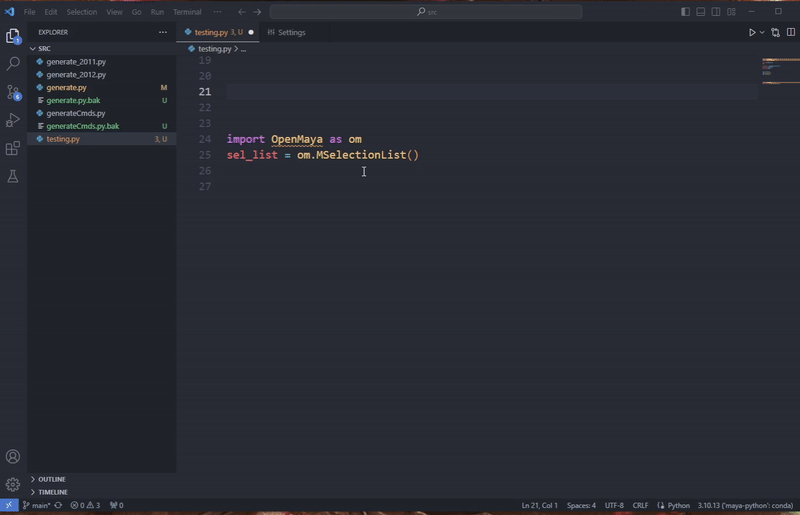

Downloaded VS Code (Pylance) and pointed it to the stub files I have generated. It handles the overloaded methods really nicely.
vsCode_mayaOverload
It provides a nice page flipper widget for the different overloads. And once you have it filled in, it will know to only display the overload that is currently used.
