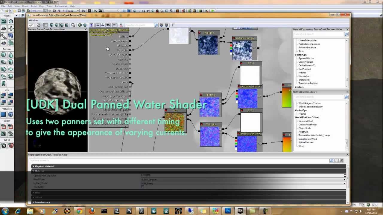

prison level: for the wall shader, I kind of want to see a nice high res screen capture of you painting the wall textures, so I can get a good look at what the artist can do with your shader. Shader work is going to really look awful with the low-def imagery, because shading is such a visual discipline. Don’t show me the graph node unless it’s large enough for me to see it and read it and/or you walk me through the techniques you’re using. Same goes for the water shader, which I don’t think I saw working in the reel (if you can’t actually show the shader in game, and there isn’t some sort of major technological awesomeness going on, why is it in your reel?

Yeah I’ll admit I was having some issues with camtasia capturing while running. (The rig capture and some of the UDK material- particularly the water shader didn’t flow at its normal speed when capturing). I’ll also try rigging someone else’s model, cut the wireframes, and redo the Defender model.

[li] Show only parts of the interface that are relevant! No one can read all the small text in the Maya or UDK UI in a video. It is a distraction. Also, another pet peeve of mine, avoid moving around windows mid video. No matter how impressive the work is, it always gives the impression you are fumbling around.[/li]
