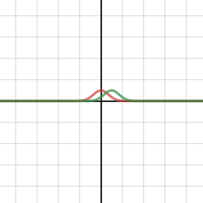

Now there are several versions of the RBF interpolator - Guassian, Multi-Quadratic, Linear etc… Anything other than Linear will require a epsilon variable. Here’s a graph I made showing Gausian and the epsilon c value - which is a constant across the system. It basically describes the falloff the poses will start to blend with each other.
