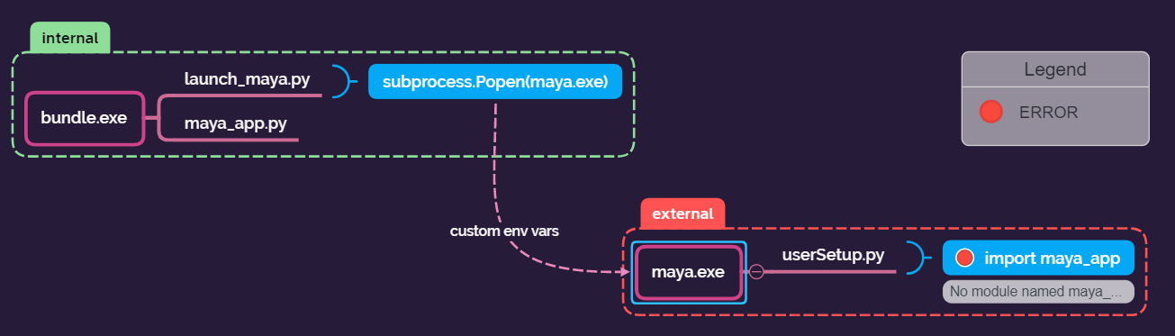

I’d like to import internal exe modules from an external process. I can do this fine from an IDE, but when I package the project with pyinstaller, and then run it, the modules can’t be found.
Here’s a high level illustration of the workflow:
Importing maya_app from within the external userSetup.py returns an error: ImportError: No modules named maya_app
The whole workflow works when I run it from an IDE (because it’s just normal python), but when I launch Maya from bundle.exe Maya doesn’t seem to retain any knowledge of the modules.
One special thing I do during the subprocess.Popen is insert Maya’s expected values for PYTHONPATH and PYTHONHOME into my environment variables because my tool is Python37 and Maya is Python27. This actually works and Maya uses its own python packages, but maybe it’s wiping the knowledge of my modules? It’s unclear how I’d test this.
I found this post on stack overflow but I couldn’t get it to work for my setup.
Is this even possible? Is there a way for Maya to inherit the modules during the subprocess.Popen? I’d like to solve this without exposing the code to the user in the exe directory, but it seems like that’s the only solution at this point.
