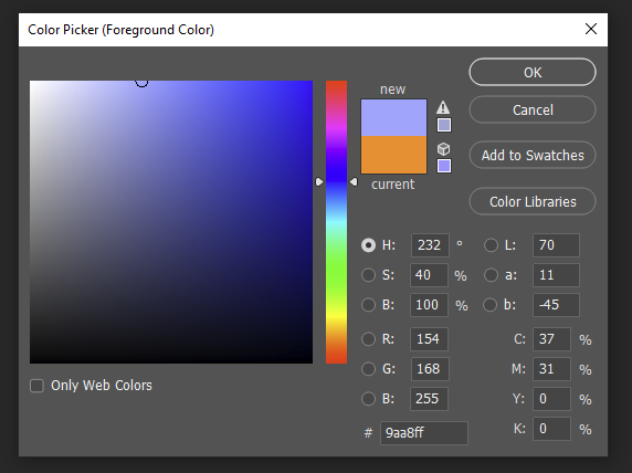

Got it! You guys will not believe how simple this was, and how unintuitive imo. I had the highlightColor set to the whitest possible color and was getting no results. The common factor among the icons that didn’t highlight was that at least one of the RGB values were already the highest they could go (255/1.0), somehow preventing the other 2 channels from increasing closer to white.
Instead of a totally bright blue or orange I now use a slightly darker color and highlight is back to working!
