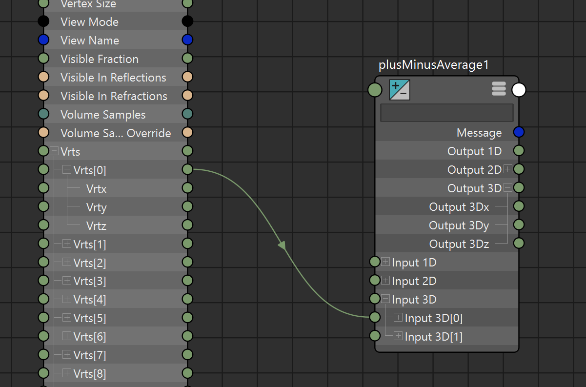

In theory, adding them (using plusMinusAverage node, for example) by making direct connections of matching vrts-pnts pairs should work:

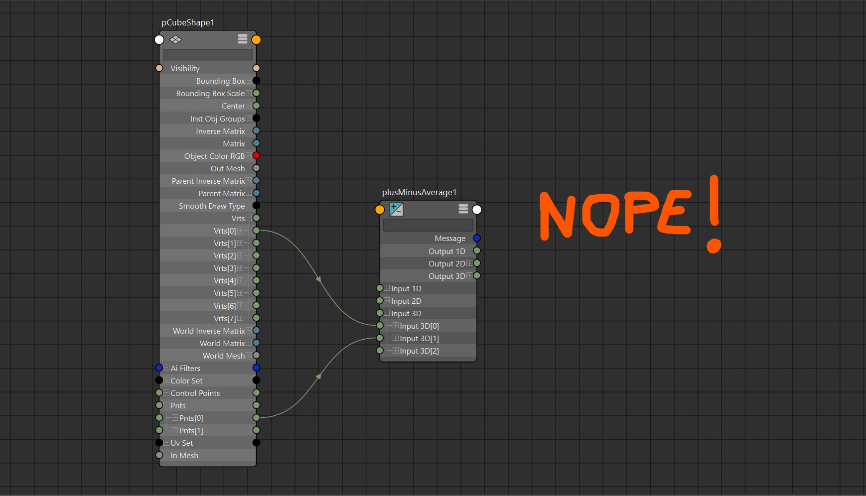

But, vrts attribute is marked by Maya as internal (mesh node), and shouldn’t/mustn’t/can’t be used in this way - it won’t give any meaningful values, when directly connected, just zeros.

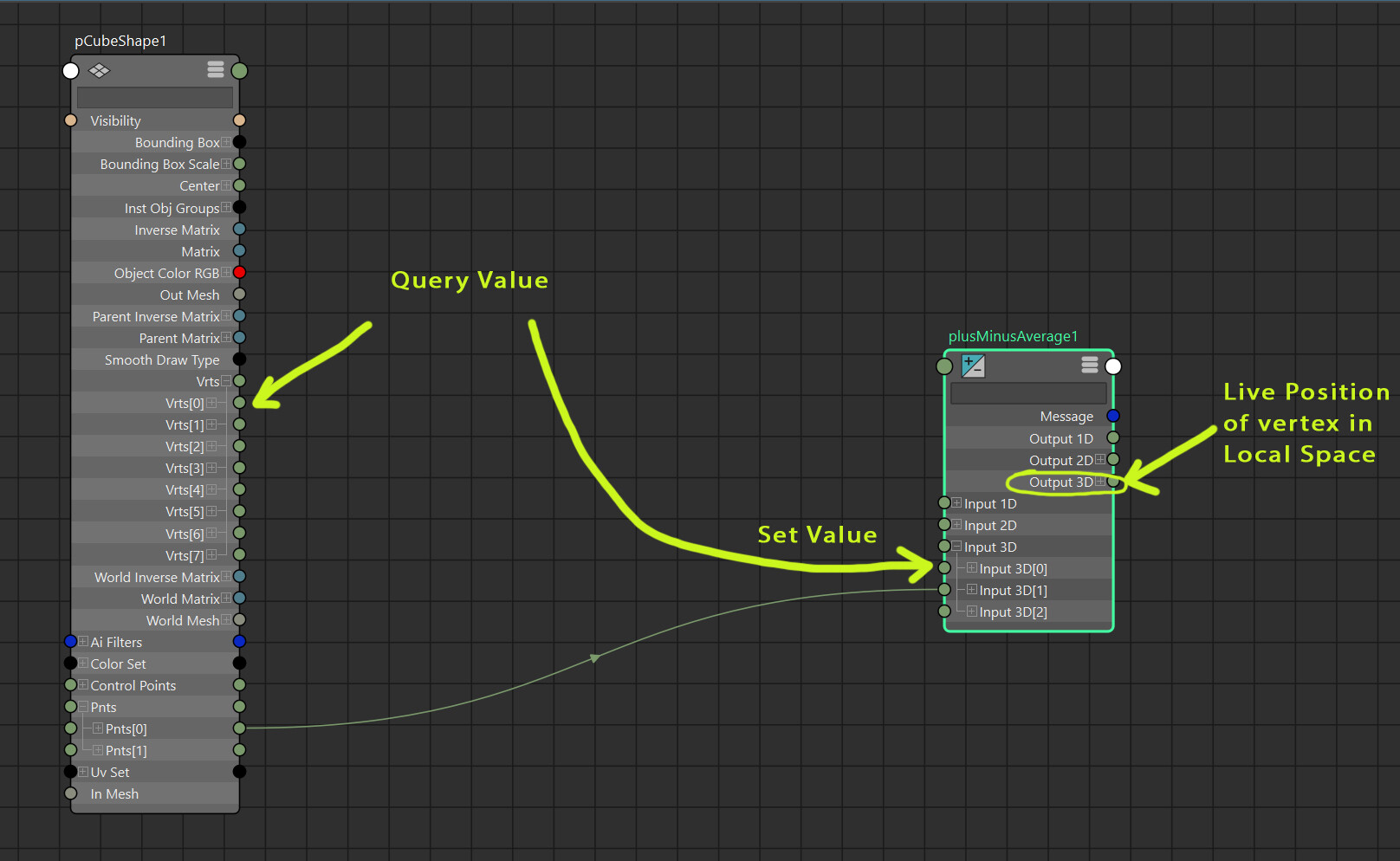

Since this attribute generaly isn’t changed (unless operations, like merging, welding, changing mesh construction input parameters, etc., are executed, that force updates of vrts attribute), you could query its values (using getAttr will give you correct results), and set them manually as one input to the plusMinusAverage node, while other input is direction connection to pnts attribute at same index.
This will give you “live” value of vertex position (you need to do this for all vertices of interest):

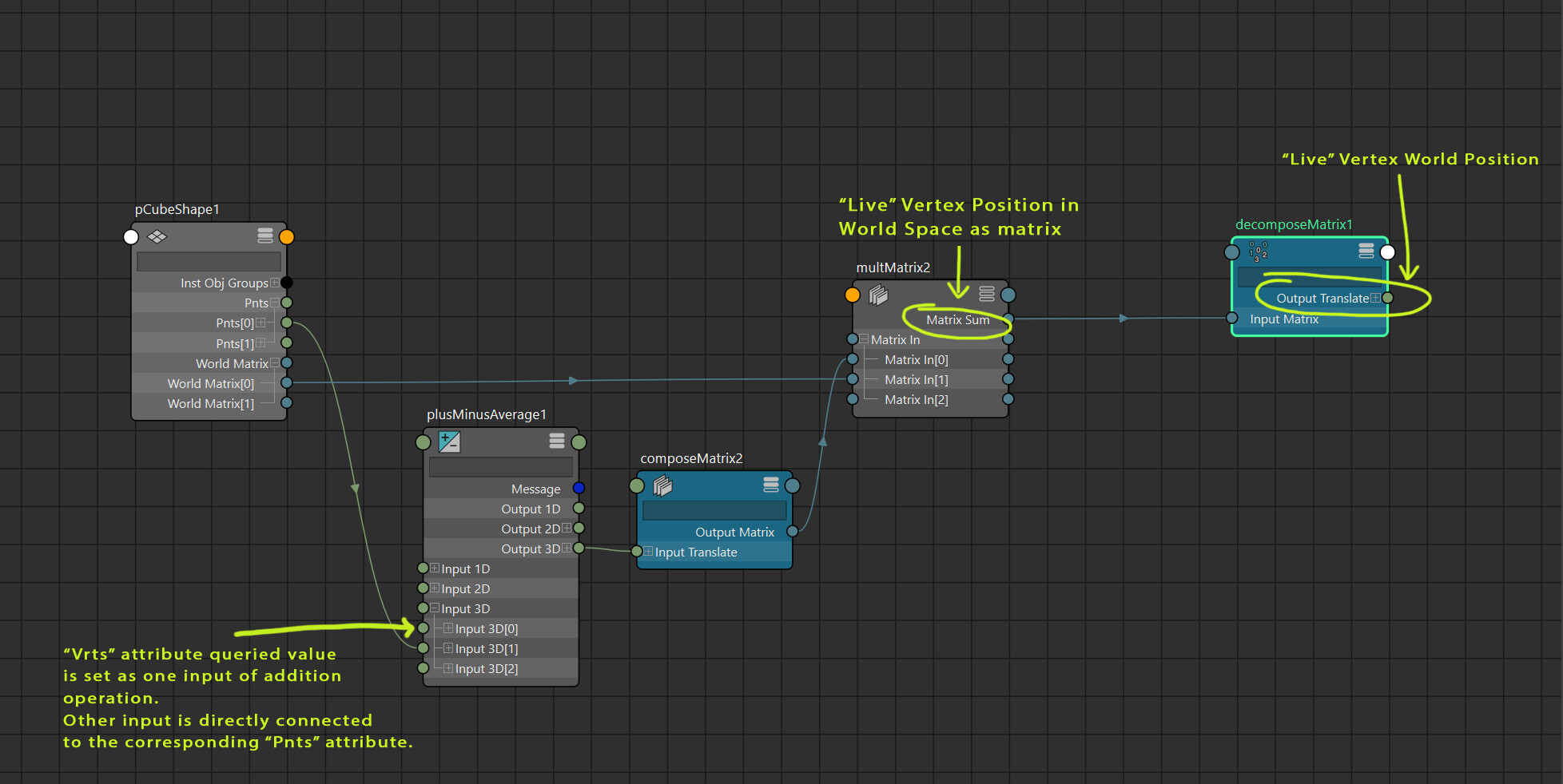

Only thing left to do after that is to convert those positions to world space. Autodesk says matrices are post-multiplied in Maya (transform node), so you just post-multiply object-space points (positions) by world matrix (world matrix comes second in multiply matrix operation), to get world space coordinates:
