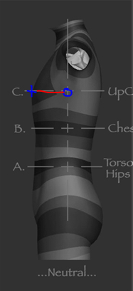

This image will explain the projection example better.
The blue circle is where you positioned the control, you then do a raycast to get a hit point on the mesh ( blue cross ), the difference in length between those two points ( red line ) can be used to scale the control to make sure it clears the geometry.
