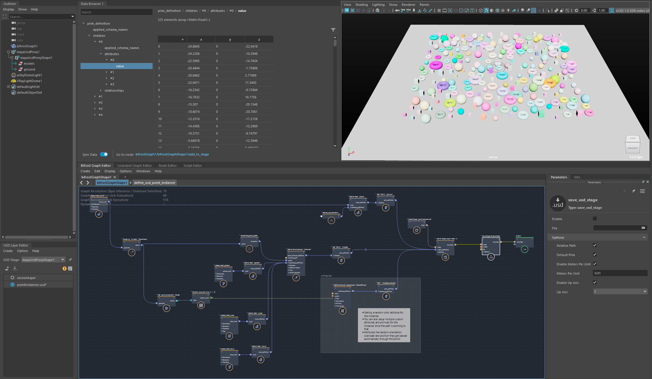

I finally had time to put a quick test, even if you already figured out or even if this might not what you wanted. It might benefit someone else, as you can see is all run through BF and all procedural obviously since is done in the graph.
You can render the graph directly in Arnold and Vray since both support Maya USD, so any engine that support USD in Maya should be able to render the BF graph. I think RS is coming with a procedural and you should be able to load the the usd data directly but not yet Maya USD. Im not sure what other engines support USD at the moment.
I also added a random color for the instances and you can add any custom attribute or primvars through BF as well. There is a lot more that you can do. But that is the basics.
Plus you can also shade the prototypes through LookdevX.
Quick video showing
quickvideo
