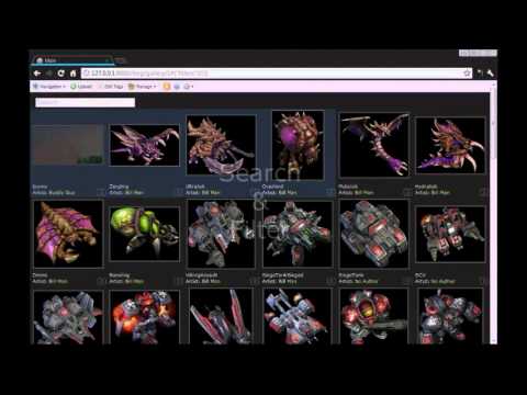

Hello all, I have been working on a media site for artists in a creative dev environmental like games or film. Basically its a single place to find and view images and video from your teams. I wrote something similar while at blizzard and they found it irreplaceable and still use it today. If your team is still using a network share for viewing images, you really should consider this or something like it. If you are using something, i’d love to see it, always good to get new ideas. And if you have any feedback, i’d love to hear that too.
Thanks
