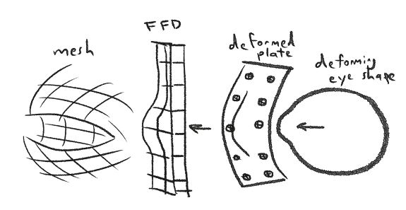

Fair enough. If extreme realism is your goal, you may need more precise deformers.
But maybe there is still a way to separate it somewhat so you can still use a lattice.
Use a shrinkWrap style deformer on a basic plane. Attach joints to that plane. Drive an FFD lattice with that plane. And then deform your eyelid geo with that FFD lattice.
This way, your complex deformer is stored on a simpler geometry. Passing it through a lattice would still let you create that slideable deformer space, which would let you pass your blink shapes through that bulge shape.
Not sure if that helps, or if it would work. Just some ideas. I would still personally avoid using any complex deformers directly on geometry.
