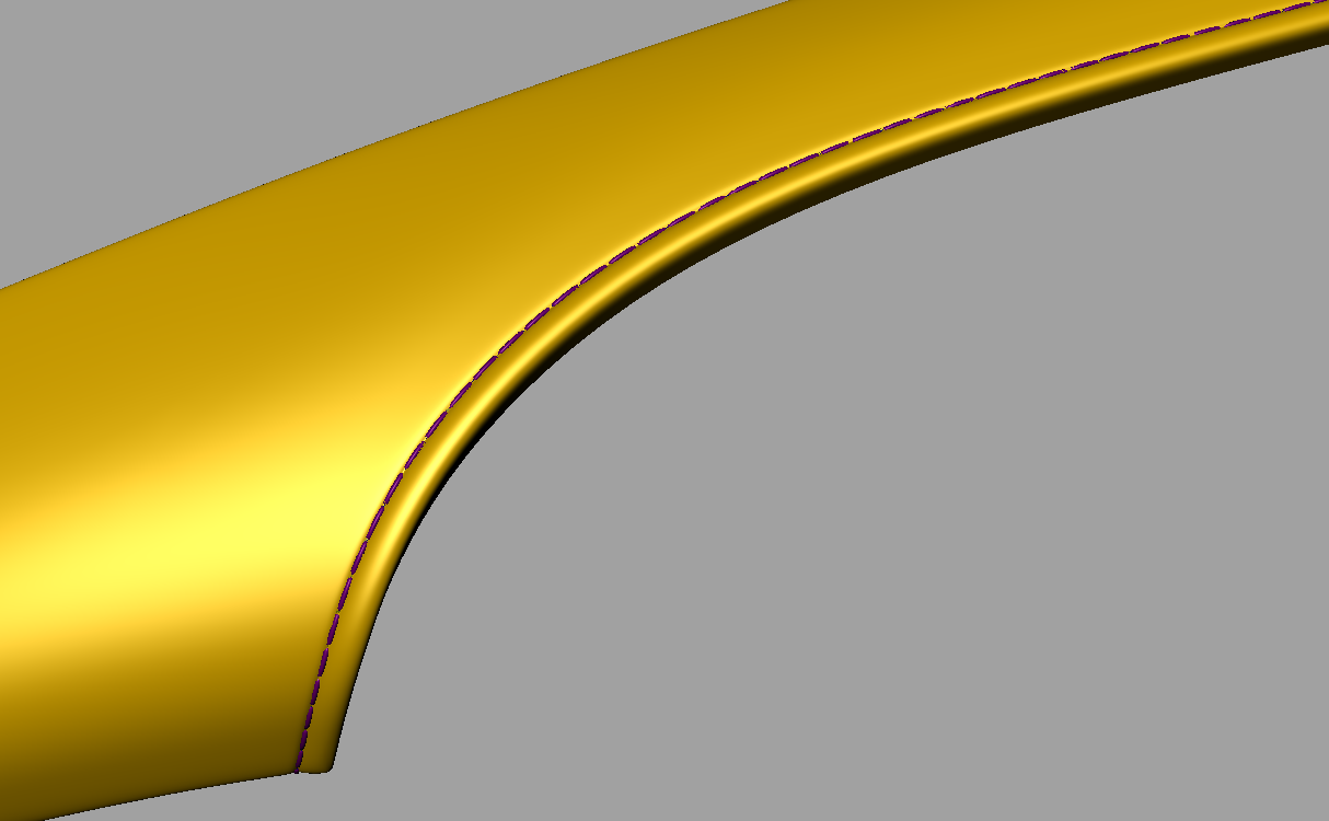

Despite the overall result may look good enoph:
the details are unexaptable…
The lattice is irregular:
And also I can’t rise the lattice resolution as much as I may need, after 400 division lattice become to broke my geometry. Here are 400 and 401 divisions:
If irregularity comes from bad algorithm of taking normals from surface vertices (and potentially can be fixed), I have no idea how to solve latice resolution limet. So I am looking for the new ideas for the same initial task: place stitches on surface.
