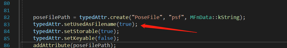

Excuse me, I am trying to write a Maya custom nodes, I try to use “typedAttr. SetUsedAsFilename” to create the file after the specified path, what I need to get him inside of Numbers.
Can someone tell me where to look for cases, or can someone tell me what commands I can use to implement, the Maya documentation is not very friendly for me as a beginner
Now I can only input of the file path. Later, I want to save the values in the file into an array. but I can’t understand the Maya Examples one week .
setUsedAsFilename() is just a way to mark a string attribute as being a file path so that the Maya GUI will allow you to use a file browser to populate the string attribute. It does not do any actual file import or export. You have to do that manually.
