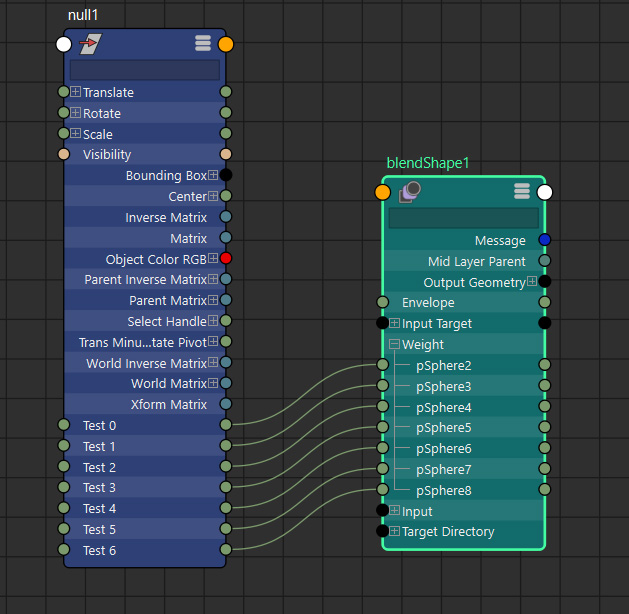

For example, after I deleted some random targets and added new ones, I get this, out of order:
for each in pm.PyNode('blendShape1').weight:
print(each)
# RESULT:
blendShape1.weight[0]
blendShape1.weight[2]
blendShape1.weight[3]
blendShape1.weight[4]
blendShape1.weight[6]
blendShape1.weight[7]
blendShape1.weight[8]

And lastly (sorry for the huge long reply), you donât need to use a range to iterate over things in Python. Iterate over them directly when possible.
And you can combine two lists together by using zip(). For example:
for eachLeft, eachRight in zip(left_LIST, right_LIST[1::2]):
cmds.connectAttr("null1." + eachLeft, "blendshape1." + eachRight)
