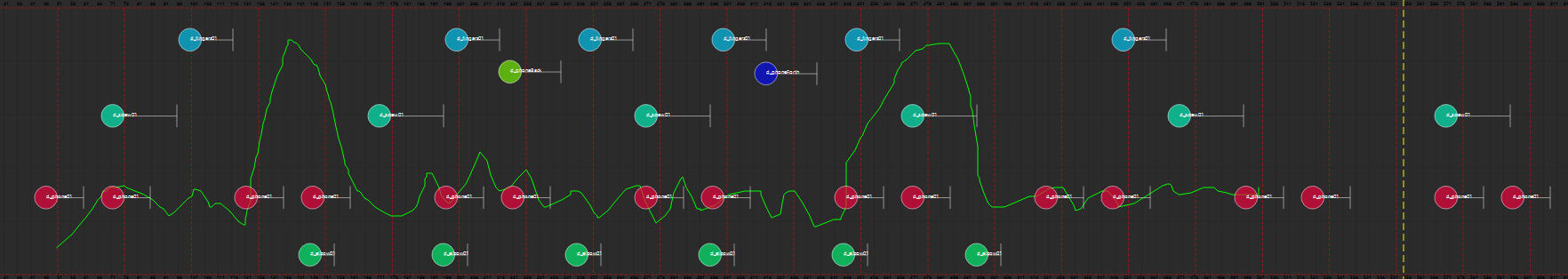

This Python Interface for Maya was born out of the frustration with the Trax Editor and the desire to associate sounds with animation clips and have immediate audio feedback in the Maya viewport.

That is really nice, i love the use the of the Graph Editor to display time based data (as opposed to having yet another window to manage). Excellent work.
Are you using a QGraphicsScene to draw the events?

Hey, thanks for the feedback!
Yes I’m using the QGraphicsScene class, it makes these kind of things so much easier…
