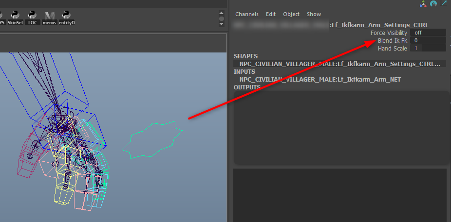

It sounds like you are using a specific rig that has IK/FK switching built into it, and talking about a custom channel box attribute. Here is what an IKFK blend attribute looks like in the channel box for the Left Arm IKFK control of one of our rigs:
IK/FK switching is not an out of the box , global Maya node feature, but something character riggers build into the control rig of a character. IKFK Blend/switch attributes are added to a specific control objects, and most control objects do not have it. You must have that control object node selected for any custom attributes - like IKFK Blend - to show up in the channel box.

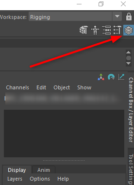

It occurs to me that as you are new to Maya you may not realize how to view the channel box in the first place. The channel box is the “tab” where an IKFK switch will typically be accessed (assuming your selection is correct). It’s in the upper right corner.
