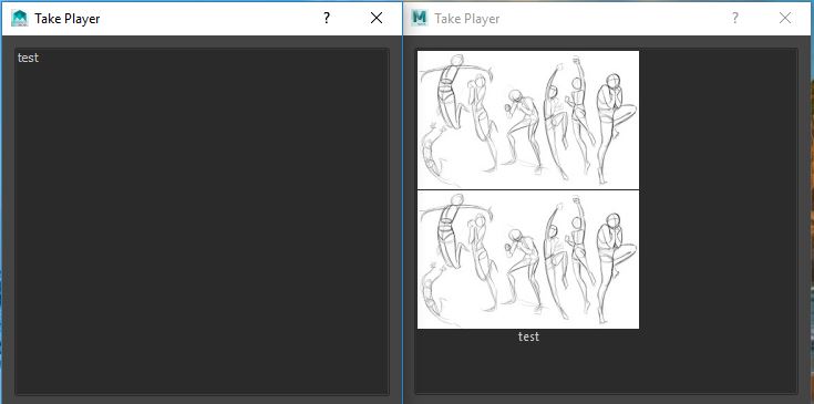

I’m converting a script from maya to motionbuilder. And noticed thumbnails not showing up in motionbuilder…? Is there some trick to getting thumbs working in motionbuilder?
Here is an excerpt from what i’m trying to do:
icon = QtGui.QIcon(“path.jpg”)
newItem = QtGui.QListWidgetItem(‘test’)
newItem.setIcon(icon)
list.addItem(newItem)
hmm… I’ve just quickly checked how I add icons in Mobu. I use this combination:
item = QListWidgetItem(“name”)
icon = QPixmap(‘D:\icon_file.png’)
item.setIcon(icon)

heh, yeah, QImage is supported in mobu 2017 and there is option to open tif and save as png, but my first try failed. It return False when I load tif. need to do more research.
