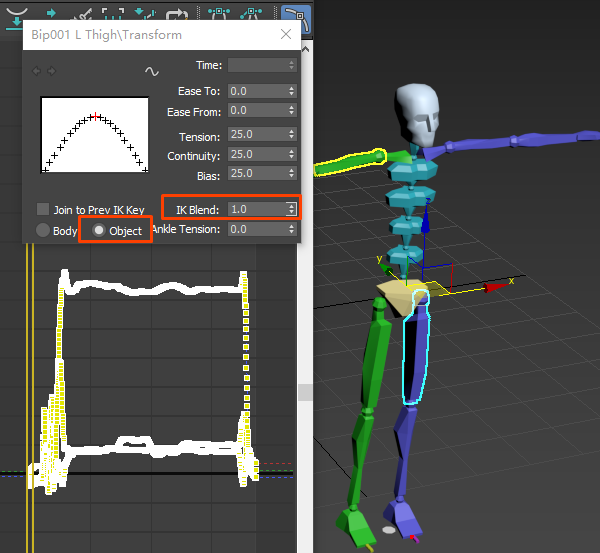

How to use maxscript quickly set all keyframes to Sliding Key?
“SetSlidingKey()” Only the current frame can be set.
Do you have a better way?Thank you!
