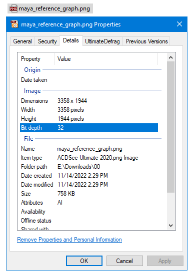

I assumed that the problems are related to layers or Color type/Bit depth.
Windows shows in the file properties that color depth = 32.
Obviously, such information is specified in the PNG-Chunks of this file.
When opening this image file in Photoshop, it turned out that the image contains one layer and has RGB / 24 color models.
Many conversion tools (or import/export tools) rely on data contained in metadata or specific chunks rather than actual data. Or they neglect the image file format standards that declare strategies for extracting and interpreting erroneous/unknown data.
All implementations must understand and successfully render the standard critical chunks ( Chunk Specifications ).
A valid PNG image must contain an IHDR chunk, one or more IDAT chunks, and an IEND chunk.
The PNG format specification requires the presence of an “IHDR Image header”.
The IHDR chunk must appear FIRST.
It contains:
Width: 4 bytes
Height: 4 bytes
Bit depth: 1 byte
Color type: 1 byte
Compression method: 1 byte
Filter method: 1 byte
Interlace method: 1 byte
Obviously, the data in the PNG-Chunks file is not correct.
Most likely, this data was not updated/replaced during the image conversion process.
