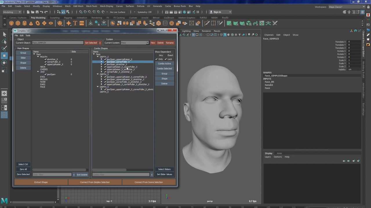

Glad to help. I’ll have to look at the install script and see if I can figure out how it failed.
Also, it seems like the upgrade to the new forum nuked the link to the simplex youtube walkthrough, so I’ll just re-post that here.
Yeah I have found it on YouTube randomly searching for Simplex related contents, thanks a lot.
I am checking it out, it is great! :smiley:
