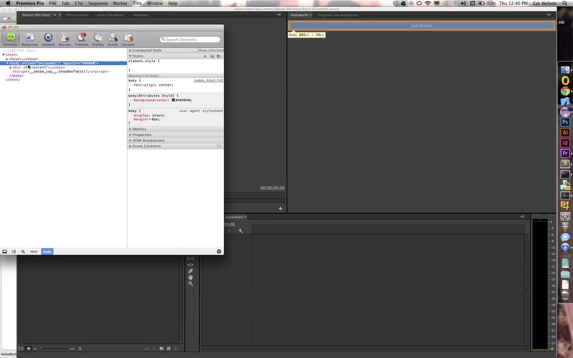

Set up your .debug file- this defines the port that CEP uses to enable remote debugging for your panel. From chrome, you can then browse to http://localhost:8088 (default for photoshop) and use the developer tools when testing your panel.

yes, get a .debug file!
<?xml version="1.0" encoding="UTF-8"?>
<ExtensionList>
    <Extension Id="EXTENSION_ID">
        <HostList>
            <Host Name="PHXS" Port="8001"/>
        </HostList>
    </Extension>
</ExtensionList>
