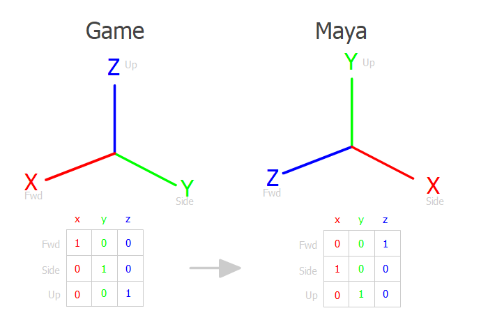

The image below shows the logic I followed building my matrix, based on a thread from gamedev.net I believe, asking What basis do I need to multiply each XYZ component by to orient it correctly in the new coordinate system?
engine_to_maya
This gives me a 3x3 column vector matrix, and I am not sure I correctly converted it to a 4X4 MMatrix.
In the API docs MMatrix is just an abstract [4][4] array with no defined ‘roles’ for columns or rows or cells.

@ross-g your example MMatrix actually seems to swap rows & columns vs the MMatrix I built in my example. My X vector for example is row 0 where yours is column 0. Is your method correct , then?
This is a source of confusion for me, as I haven’t found explicit documentation explaining what the columns or rows of MMatrix are supposed to represent as far as XYZ vectors.

Thanks again to all for your feedback. I now am successfully converting the data into Y up Maya space via a transform multiplication.
@Theodox I scrutinized out engine to make sure the handedness wasn’t flipping. I remember that frustrating me in a Max (Z up RH ) to Unity (Y up LH) pipeline a few years back.
