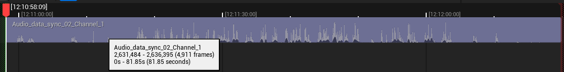

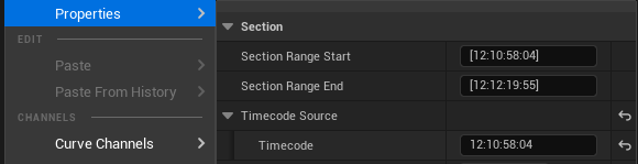

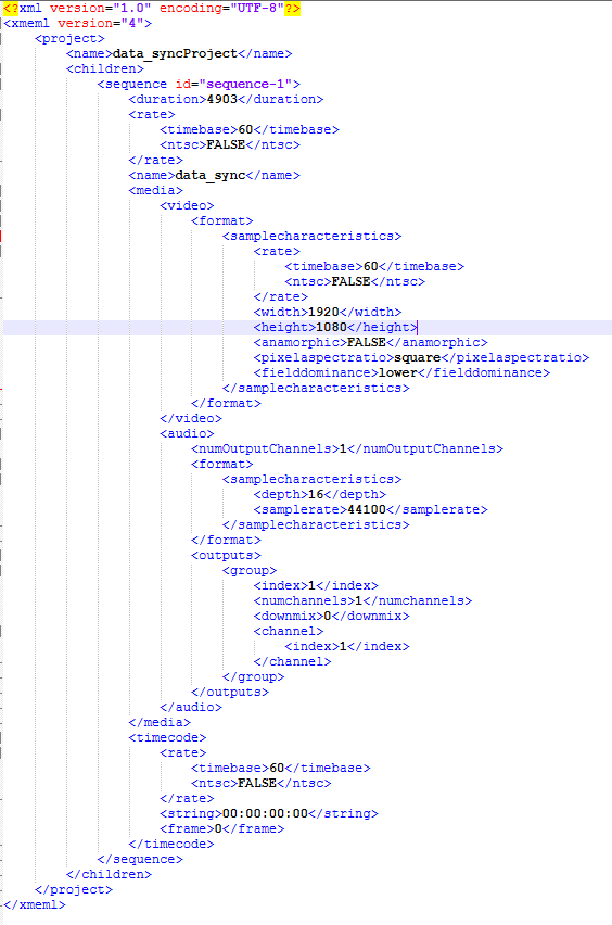

I’m looking to export an audio track with its timecode data, through the movie render queue, to sync with animation data in another software tool. I have continued to encounter issues with no timecode data recorded, or data beginning at 00:00:00:00. Does anyone have any insight or knowledge on exporting timecode data from a take sequence out of unreal?

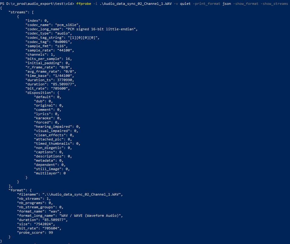

I’m somewhat unsure why this method works instead of configuring sequence exports using the render queue settings, but I’ll continue to see if I overlooked any settings. Additionally, due to how the movie render graph handles wav exports as a global output node, audio is not encoded with the video file, but is instead exported as a separate wav file. This can be combined in an NLE like Resolve or Premiere, and potentially automated with some scripting.
