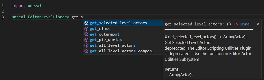

Code Completion:
Run the command Unreal Python: Setup code completion and it’ll automatically setup code completion for Unreal Engine based on the currently opened UE instance.
