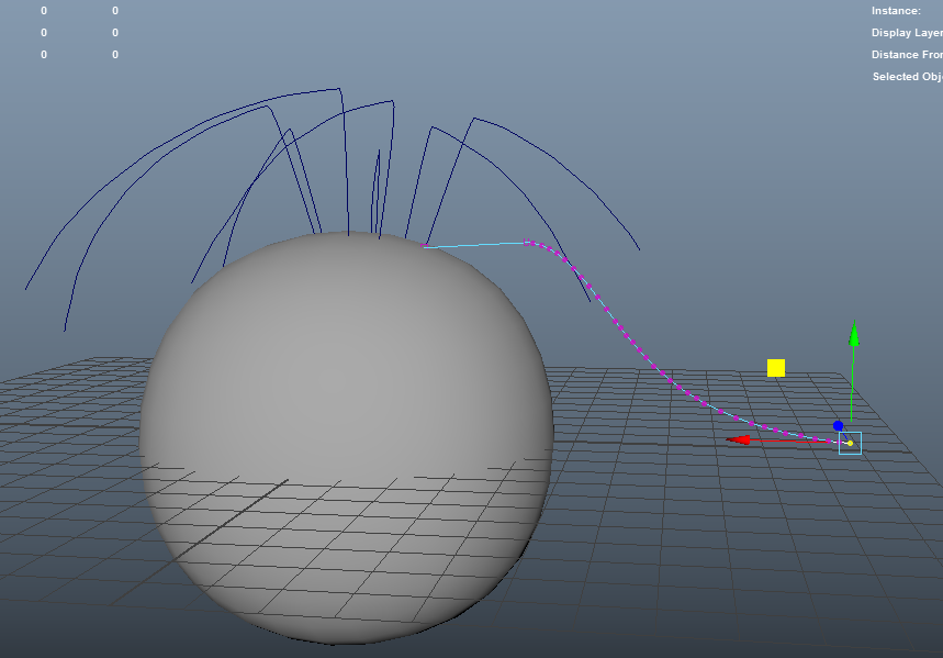

The script should take the position nearest to the first CV of a given curve and snap that CV to that point on the mesh WHILE keeping the length. The script kind of works, but for whatever reason it doesn’t keep the length, though the attribute becomes turned on and works well if the CVs moved manually

okay. it worked this time. but I am back to square one again.
If I manually grab a cv it’s locked indeed. But with the script it just stretches the curve and snaps the cv.
