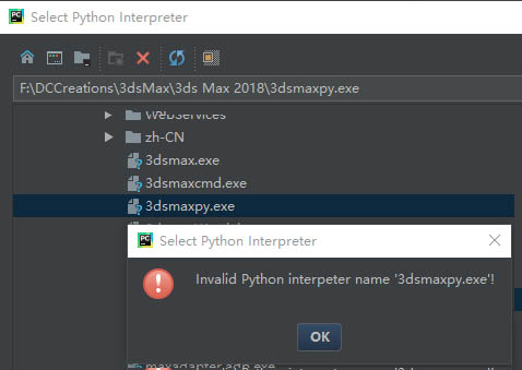

Does anyone know why pycharm can’t recognize 3dsmaxpy as interpeter ?
I’m using 3dsmax 2018 and want to setup pydev-env, but i got this strange error.
error_pycharm_3dsmaxpy
I don’t know exactly, because I don’t use PyCharm. I can say, though, that I have set up a custom Python environment for 3ds Max 2018 in both Visual Studio 2017 and Wing 6. So it is possible.
Went down this rabbit hole a while back. If I recall correctly, I was able to get it to work by duplicating 3dsmaxpy.exe and renaming it to python.exe.

Instead of duplicating and renaming 3dsmaxpy.exe to python.exe and possibly having issues with multiple interpreters running, it’s probably safer to just create a symbolic link (if you’re in Windows). This will generate what is essentially a shortcut, so you would have a symbolic link (commonly abbreviated to “symlink”) then called “python.exe” which is actually pointing to “3dsmaxpy.exe”, so that both Max and your IDE are running the same interpreter. Then you just point your IDE’s interpreter to the symbolic link called “python.exe”.

i made a plug-in that adds support for 3dsmaxpy to PyCharm
http://rightsomegoodgames.ca/downloads/3dsMaxPy_plugin.jar
i also added a pull request to the official pycharm repo for the fix as well so it can eventuality be included out of the box.
https://youtrack.jetbrains.com/issue/PY-26863
