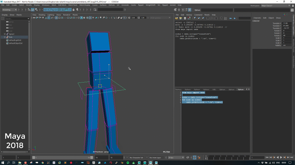

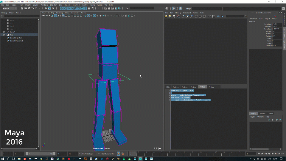

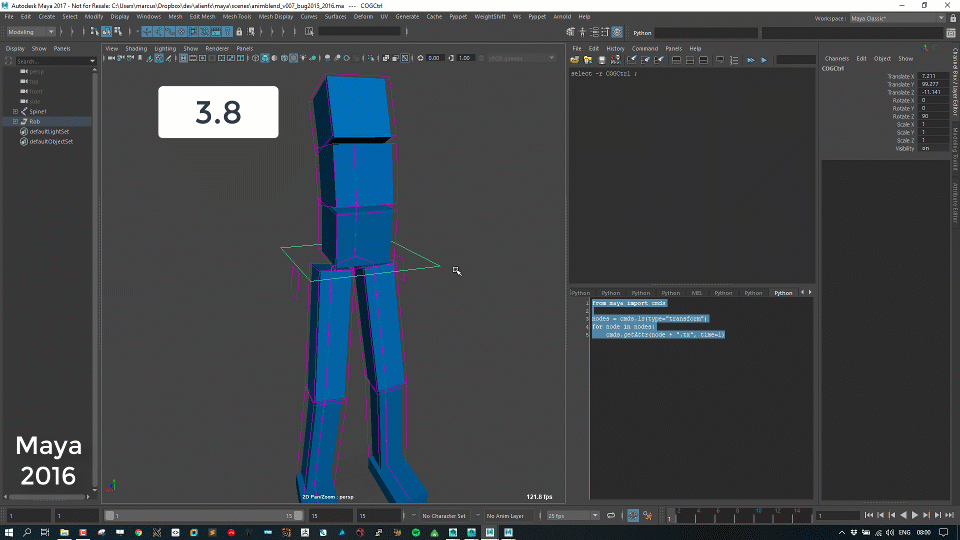

I’ve hit an interesting problem that I hope you can help me with, and have narrowed the problem down to a minimal scene.
In a nutshell:
  1. On scene open, the scene is fast
  2. On querying transforms at e.g. time=1, the scene is 50x slower (see below)
  3. Only happens in Maya <=2016
  4. In the scene, ikHandle nodes for the legs, decomposeMatrix for IK/FK switch and driving the meshes with the control rig and switch for toggling IK and FK.
  5. With IK deleted (even though it’s hidden and not in use) the scene is quick again.
  6. On deleting history for the boxes, the scene is 2x+ faster; they have polyCube and others plugged into it.
(5) is perhaps the biggest clue.
# Source of error
from maya import cmds
nodes = cmds.ls(type="transform")
for node in nodes:
    cmds.getAttr(node + ".tx", time=1)
The lines of Python I’m running are these, notice the time=1 argument; without it, there isn’t a problem. In the videos, notice how the scene is fast until I run the above script, after which it’s 50x+ slower.

2015 SP6 2016 EXT1 SP6
2017 2018 Update 4
Oh, and a few more things.
  • The problem only occurs on moving the manipulator. Playback is unaffected.
  • The problem appears in Maya 2015 SP3+, SP2 is fine
Mystery!
