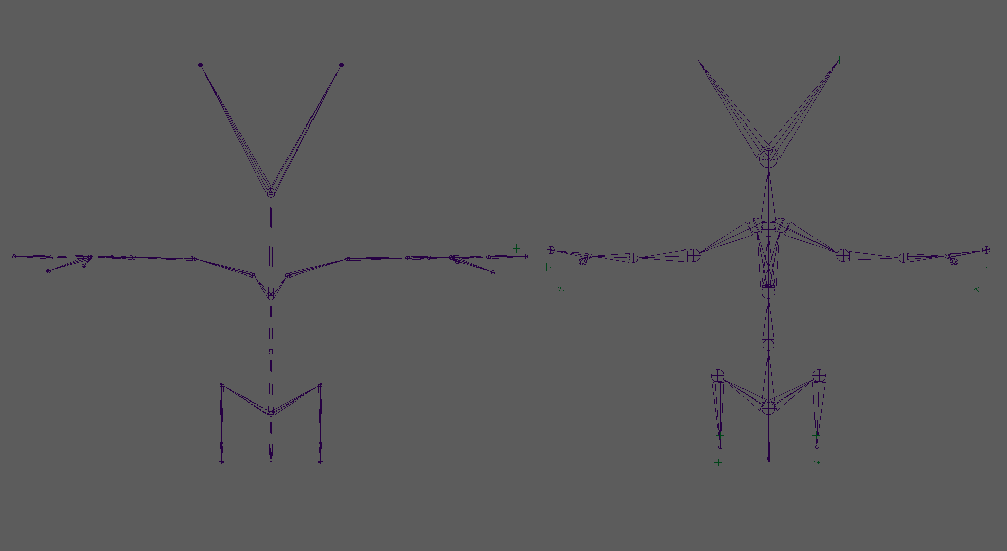

Here is a screenshot of the rigs
So this looks like transferring transforms - you should be able to do that using parent constraints between the target > source joints using maintainOffset. The general process is you align your target or source to the other, create constraints on the target to the source and then apply motion to the source. This way the target would ride the source skeleton - you then bake down the constraints to keys.
So I would align the target to the source, or vice versa. Then apply constraint on the target joints to glue them to the source with maintainOffset on. Finally I’d apply motion to the source and bake down the resulting constrained target to keyframes.
This is the basics - it gets a lot more complicated transferring systems, like ik between each other.

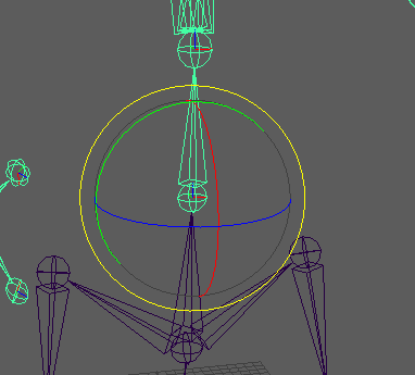

I created basic controller for both skeleton. I parent-constraint the skeleton to the controller of the first skeleton, then parent-constraint the controllers to the controller of the 2nd skeleton, then parent-constraint to the skeleton…
I did it with 2 sets of controllers because I thought it would be better to retarget when the controllers transform are at 0, 0, 0. But I don’t know if it’s really necessary.
As for the scale, I did it with the connection editor to connect the right axis.

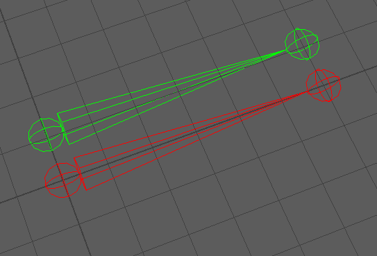

That’s what I did.
I created 2 bones and tried de retarget these 2 bones onto another set of bones.
They have the same rotation and scale. But the target bones have a minor translation to the left.
From what I saw, it seems like the matrix are not set properly.
My source bones go from 6, 0, 0 to 6, 0, 3 in translation
and after retargeting, the translation is 3, 0, 6
