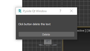

I cleaned up a little bit the code, it was messy.
This sample is intended to display the problem

This is what I have before and after clicking the button.
Is this a bug?

Yeah that definitely looks to be a bug. I don’t have access to 2019 as I am not at work but you could try the following as a work around:
self.label.setMaximumHeight(0)
Or:
self.label.hide()
That way you can hide the label and keep it in your layout to be reused later.
I will test on another max version asap to give some information to Autodesk about the bug
This combo actually removed the widget, thanks for the suggestion
