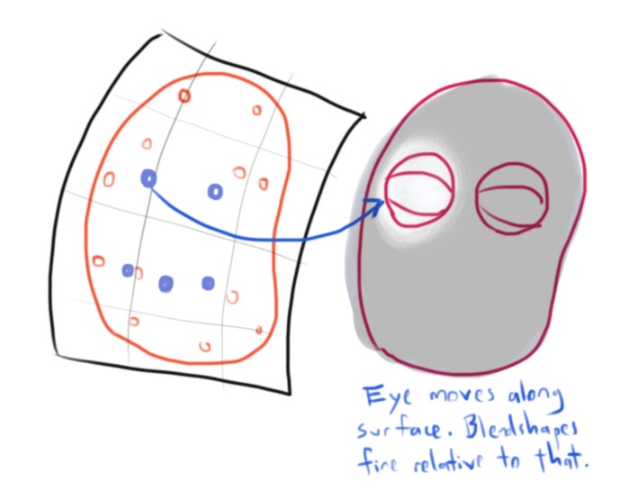

I’d think about it in terms of layers. Have a simple sphere in the shape of the body. Deform that sphere with a big body-shaping set of joints or lattices or whatever. Pin joints to that surface. Those joints carry along the position of the eyes on the actual mesh. If you just throw an FFD on top of the entire mesh, the eyes will stretch.
In this quick sketch, the red joints would be shaping the body. The black lattice is an FFD or stretch spine rig, or whatever. The blue joints would skin the position of the entire eye. And then add more joints or blendshapes to deform they eye, relative to that joint position:

Thanks again for your effort that you even sketched it:hugs:. You said “pin joints”, is it something like rivet script because I am not that good with lattices, when I basically rigged a sphere with 3 joints(2 eyes on each side and one in the middle for head representation), and then add lattice deformer on the sphere, joints doesnt move along with the mesh.
Yeah rivets or follicles, closestPointOnSurface, closestPointOnCurve or some other new option you discover and write us a tutorial about in the future!

Hello, i did similar rigs. What i did is build a spine, then attach a joint to the middle, this joint drives all the facial of the character. It’s only smooth skin work atfter that. Notice in the video that the arms are completely separated modules. Then you can do as Chris tell you, attach the modules via follicles, rivets, surfAttach or whatever you prefer.
I am having trouble when I skin the mesh with the joints, then parent the joints under follicles on the mesh and put lattice on top of the mesh, I am getting double transformations as I expected.
I tried creating blendshape and put lattice on that mesh, then created follicle on that mesh and parented the joint under it. Everything seemed to be okay but joints had no effect on the original mesh, thought it was about input order and changed it to calculate skin cluster first, then the blendshape and I got pretty inaccurate joint movement (Seemed more likely lattice border problem but I could not fix it)

The way I do this: In my drawing, the geometry on the left side is meant to be a nurbs sphere or a secondary mesh. That is the geometry you deform with an FFD.
The lattice bends the nurbs.
The follicles ride the nurbs.
The final mesh is skinned to joints that follow the follicle.
That is how I would avoid double-transforming the mesh.
