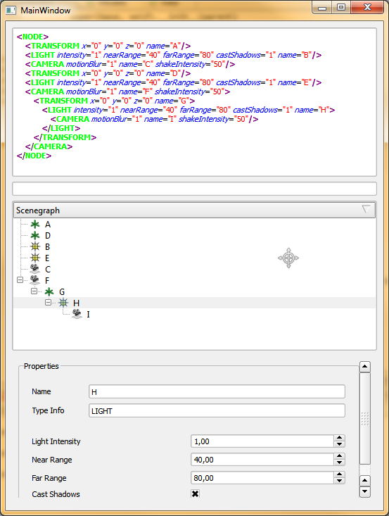

Part 07 is done recording. Just need to comp it, will do it tomorow night after intern / work.
Topics covered:
Proper project setup (Controllers.py, Models.py, Data.py AND Views/[files].ui)
Refactoring the code so it’s alot simplier, cleaner, extendible, dynamic in terms of properties setting and getting.
Dynamic solution for data, setData methods of our model
Dynamic solution for properties / attributes
Dynamic XML generation using QtXml module and some python tricks to get a list of all properties from self and entire heirarchy of super classes
Realtime update of XML viewer by property editing
Using my XML Highlighter for PyQt4 found on my Blog
Enum attributes with comboboxes
All of this in Model View programming pattern
PS: I was in hurry with the last tutorial, so that’s why I moved the refactoring into this tutorial
image of result:
Part 07 is up and on the first page Enjoy!
