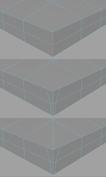

Here is what I have as source, what I done with a script and what do I need to get (split the top ace):
And this is more tricky then I expected! Cant understand how polySplit() is working, for one pair of edges i need to set distance to 0, for another to 1 to get same result:
Couple of quick guesses:
Maybe you need to input your edge pairs in the same sorted order? I can see in your example 148 < 188, but 125 > 117. Maybe that matters?
Maybe look at the vert indexes for your edge pairs, and see if the order of the vertices on each edge lets you figure that out?
