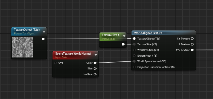

I have found one solution to this since I posted it. And that is the WorldAligned Texture node, which will only work in a Post Processing material if you adjust the normal to a Scene Texture Normal. But, really what I was looking for was simply a flat way of laying a texture in front of the camera. But when you move the camera to look around the texture stays in place and doesn’t move with you. I wanted to use that to create a mask to give the scene the feeling of being a painting.
This is a temporary solution, but I feel as tho it creates a different feel to the scene.
