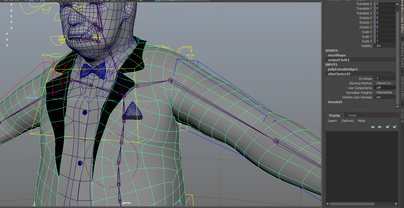

Thanks for the tip. I’m affraid didn’ work though. I hope this snapshots help to diagnose. Before taking them, I tried the deletion of non-deformer history but I don’t notice any change. To be honest, it’s the first time I use that option (I don’t have much experience rigging things)
I also notice you have 2 shapes under your transform. sacoShape and outputCloth1.
Was the polyExtrudeEdge1 still there after you delete non-deformer history? Or did it give an error when you tried it?
