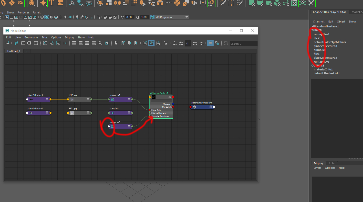

I’ve attached a couple of screen shot to illustrate what I’m talking about.
In the first screen, you can see in the attribute history on screen left that there are 7 inputs (minus the ColorMTGGlobals). In the node editor window, you can see that the graphing ends at the remapHSV from the spec roughness channel.
In the second screen, you can see that there are actually a few more nodes behind it. Those will only appear if I also select the remapHSV node from the spec roughness channel, and graph those two nodes at the same time.
At this point I’m just guessing it’s because, as I mentioned earlier, because the connection is non-standard (spec roughness takes outAlpha, but if it’s an outColor connection, it can only take 1 color channel).
I honestly have no idea though.
The way the node editor behaves with graphing that network is pretty similar to how listHistory and listConnection will show the nodes. I have to make a separate listConnection command to see what’s behind.
