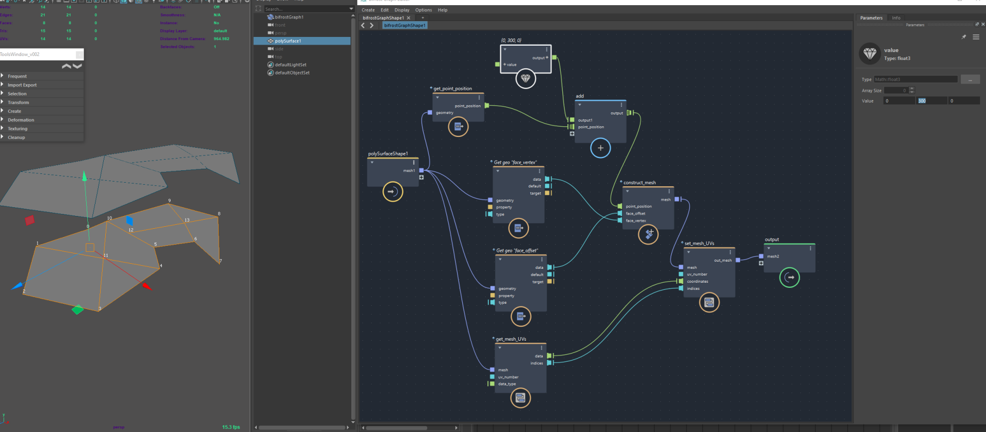

@mudoglu In Houdini, I achieved that with VEX. I don’t have any code to share as it was in another company, but basically the idea is to :
grab data from your source (for each point, get P, neighbours() and pointprim() )
recreate each point and connect them with your neighbours arrays with addpoint / create the faces with addprim
The important part is to keep a consistant @ptnum and connections between the meshs.
Winding order was a bit more complicated if I remember correctly…
