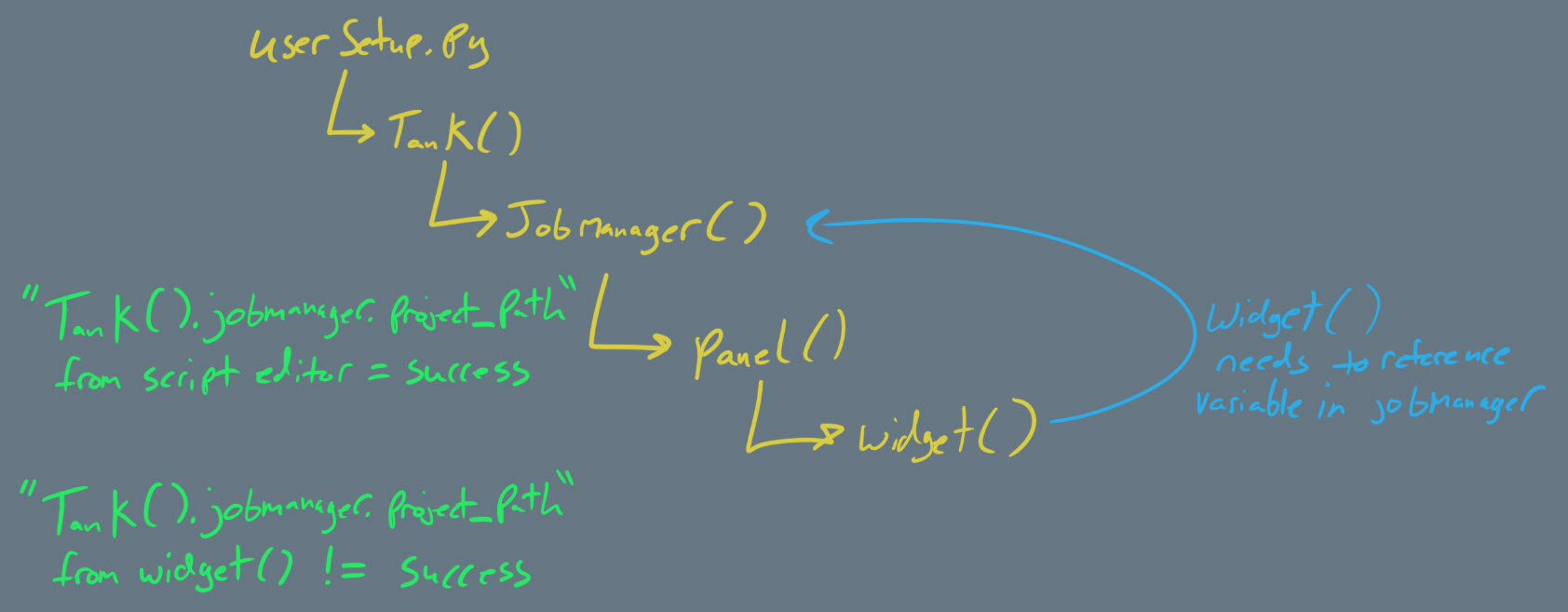

I drew a picture that might explain what I’m after better. Tank() inherets a singleton setup. In the script editor of Maya, I can access internal variables of the Jobmanager() class that Tank() initializes by “Tank().jobmanager.property” - I need to access the same property from the widget being initialized by the panel class that the Jobmanager() class initializes.
Another way of explaining this is if userSetup.py initialized a string variable such as - ’ zip = “foo” '. How would I go about accessing zip from the “Widget()” instance in my example?
